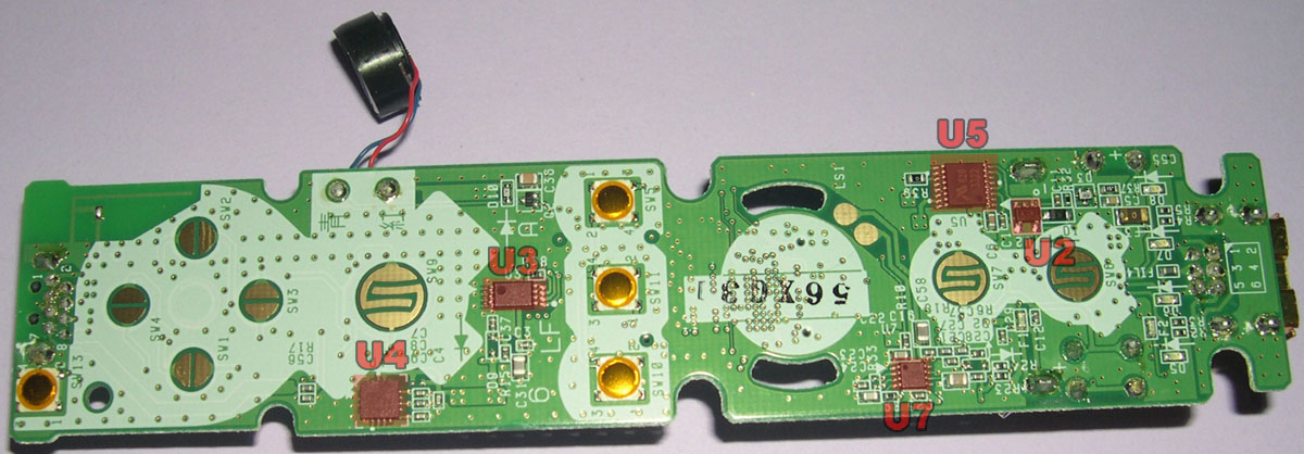

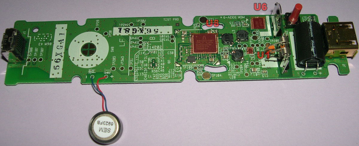

先发个WiiRemote的拆解图,国外有人猜测过细节:
Chip listing:
U1:
U2:
U3: ST Microelectronics M24128-BWP - "412A" "BWP" (128kbit I2C EEPROM存储器 - TSSOP 8脚封装)
U4: Analog devices ADXL330 - "XL" "330K" "#0614" "3464P" (三轴加速度传感器 - 16脚LGA封装)
U5: 疑似 Microchip TC1027 - "628" "3322" (四比较器 -16脚 QSOP封装) - could possibly be a Mitsumi chip (the logo is similar)
U6: Unknown manufacturer - "U7849" "6Q19" (Likely Audio DAC chip, due to proximity to U7 Speaker amp, and lack of another chip to perform this - 16 pin tsop)
U7: Rohm BH7824FVM - "H78" "2 4" "HN" (audio driver (speaker AMP) for mobile telephone - MSOP-8)
U8: Broadcom BCM2042 - "BCM2042KF8C" "C80830 P13" "788899 N1" (Broadcom bluetooth & 8051 - probably 88pin FBGA)
U1、U2不知道是什么玩意,但体积太小,不可能是复杂的处理器,其它芯片里也只有U8带处理器。玩过单片机的都知道8051是什么东西,这是INTEL经典的微型控制器内核,虽然很多公司(比如Cygnal和Cypress等等)对其做了优化,速度提高很多,但它毕竟是8位核心。即使有外围专用信号处理芯片,这个8位机的能力也是有限的。
