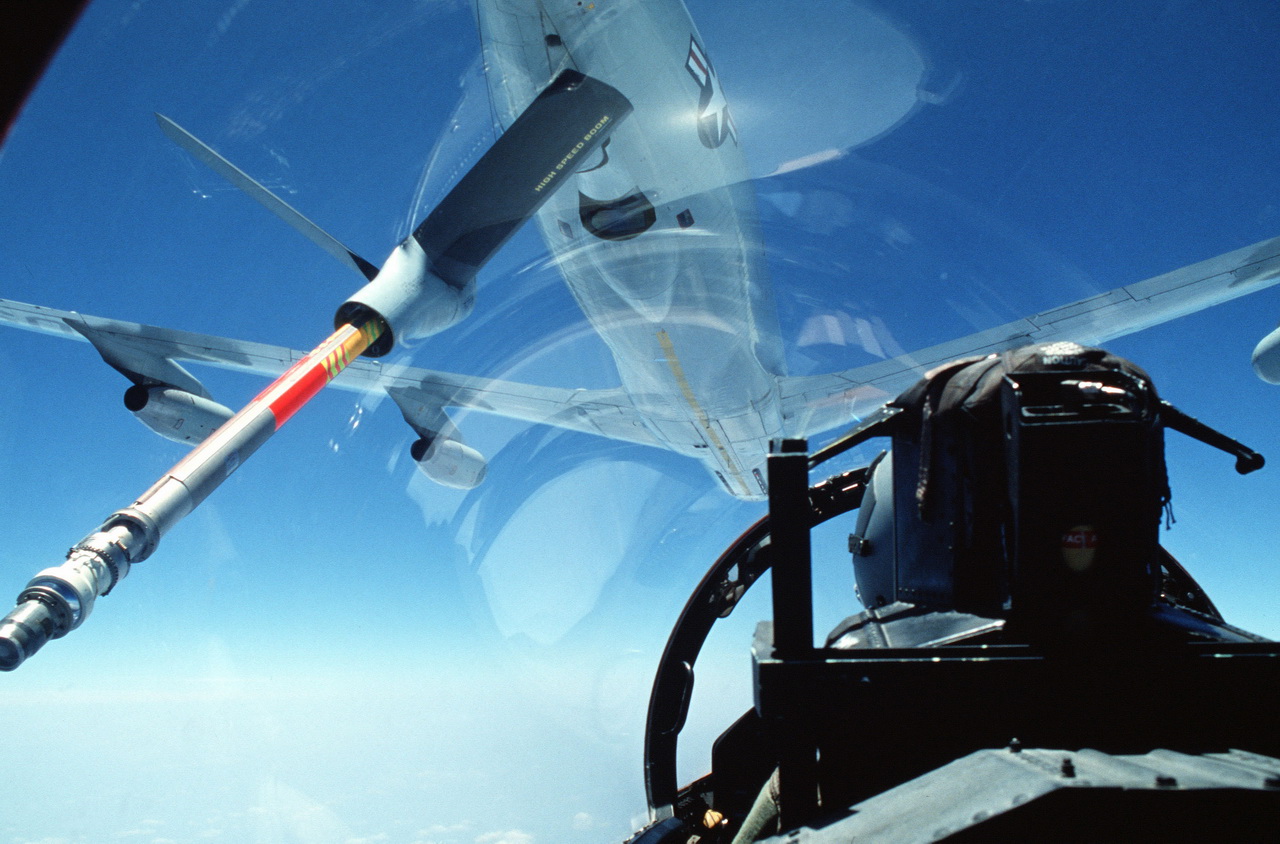

原帖由 cohead 于 2009-7-18 19:34 发表
卧槽,这样看15的视野还是挺好的嘛
这图原图我有,3000 x 1989,是在1架F-15D的后座拍的(通过后座控制台的扶手可以识别是15D还是15E)
而且是用的广角镜头,自然看起来很宽广了,实际情况没这样好
但15双座型的后座视野仍然是数1数2的,16双座型的后座都比不过
放1张同样是15D后座拍的照片,且同样是广角镜头
27楼的15的弹射座椅两边怎么有两个像翅膀一样的小东西?
那个是 ACE II 型弹射椅的标志性东西,但具体做什么用我也不清楚,没查过ACE II 的相关资料
个人猜测应该是在穿盖弹射模式下,用来加快破盖速度用的
Viper 也用ACE II,同样能看见这个东西

发表于 2009-7-19 09:30:29 | 显示全部楼层
那个是弹射椅皮托管~
现在多数最后一期CCIP过的viper这个东西都变成折叠的了~

The ACES II (Advanced Concept Ejection Seat) is considered a smart seat since it senses the conditions of the ejection and selects the proper deployment of the drogue and main parachutes to minimize the forces on the occupant. The seat is a derivative of the Douglas Escapac seat.
Removal from the aircraft is by a three part pyrotechnic sequence. A gun catapult provides the initial removal of the seat from the aircraft. A rocket sustainer provides zero/zero capability to the seat. To prevent the seat from tumbling when the aircraft is in a roll maneuver or there is a center of gravity imbalance, another (smaller) rocket called a STAPAC is attached to a gyroscope. This senses the motion and attempts to keep the seat from spinning by automaticly providing a correcting force.
Once clear of the aircraft, the pitot - static system on the seat measures the conditions and selects one of three operating modes depending on the conditions present at egress.
Mode 1 - Low speed (<250 knots) and low altitude (<15 000 feet) operation.
The main parachute deploys as the seat clears the rails. Drogue parachute remains undeployed to prevent line tangle.
Mode 2 - Moderate speed (250-650 knots) and low altitude (<15 000 feet) operation.
Drogue parachute deploys as the seat leaves the rails. Main parachute deploys 0.8 to 1.0 seconds after the drogue. Drogue chute is then released to prevent line tangle.
Mode 3 - High speed (250-650 knots) and high altitude (>15 000 feet) operation.
Drogue parachute deploys as the seat leaves the rails. The pitot - static system senses the conditions and delays the main parachute until mode 2 conditions are met. Then the main parachute deploys after 0.8 to 1.0 seconds. Drogue chute is then released to prevent line tangle.
